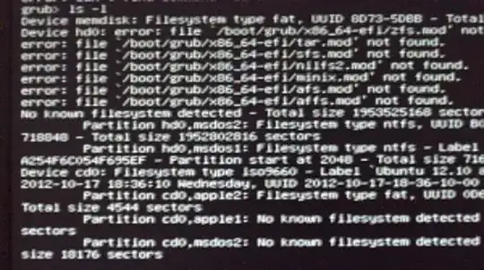

The output of ls -l at grub prompt
gruboutput

This is a bit of a long shot, but Gigabyte motherboards with the hybrid EFI have a problem with case sensitivity: Certain comparisons are done in a case-sensitive way when in fact they should be done in a case-insensitive way. My suspicion is that you're running into this problem. You might try to mount the USB flash drive version of the installer with various options for the shortname mount option, move (don't copy) the kernel file (casper/vmlinuz.efi on the disk) off the disk, and then copy it back. This may adjust the case of the filename and make the file visible to GRUB. This type of change is possible, but much harder to do, using CD-R media.
Another option is to upgrade the firmware. Gigabyte lists several updates for this board, and it's possible that one of them will fix the problem. The latest is marked as a "Beta BIOS," and it's possible it's not the buggy Hybrid EFI with which the computer shipped. (Gigabyte offers updates away from the Hybrid EFI on some boards, but I'm not sure if yours is one of them.)
If these suggestions both fail, my only other suggestion is to abandon use of EFI on this computer. If it has a Hybrid EFI, that is a VERY buggy EFI implementation, and it's almost never worth using. If you must, it's likely to be easier to install Linux in BIOS mode and then fix the EFI-mode booting once the basic installation is complete.
