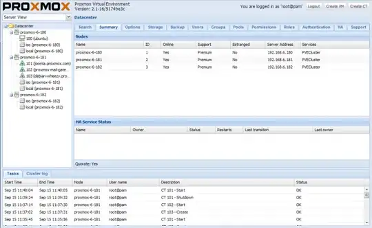

I suggest you look at proxmox
http://pve.proxmox.com/wiki/Main_Page
Offers a Debian host, web interface, and KVM and openvz. They are planning to use LXC once they consider it stable.
