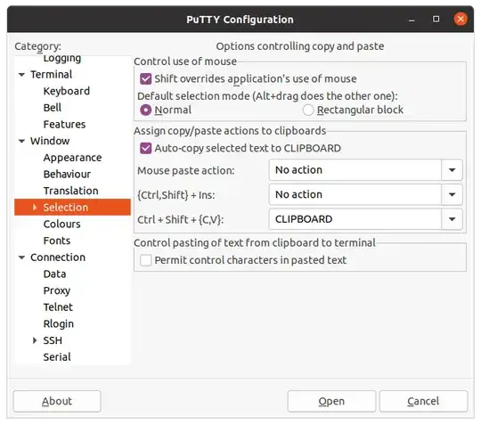

You can configure the copy/paste behavior on Window → Selection as below.
Putty Dialog
