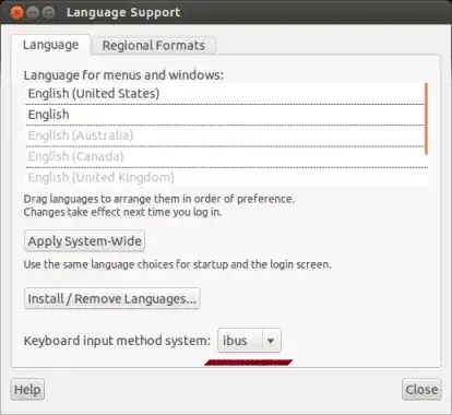

Open Language Support from System Settings
If you don't need Chinese menus, etc, you can ignore Install/Remove Languages, but in Keyboard method input system, choose Ibus.
Choosing the IM method from here automatically handles all of the backend setup for you. It's a good idea to log out and back in before doing anything else.
If ibus is already selected, you need to clear the configuration changes that came from running im-switch manually. Simply choose None and language-support will handle the needed backend reset. Log out and back in. Then choose ibus and log out and in again.
Screen shot from Language Support

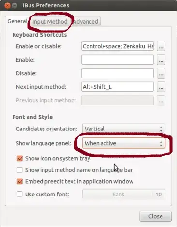

As an aside, on the General tab, it's a good idea to change Show language panel to When active or Always. There is a bug or conflict somewhere that keeps the default option of Embedded in Menu from working. The language panel provides additional functionality, such as choosing simplified or traditional characters, and has advanced options for the pinyin method.

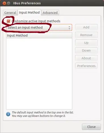

Then choose the Input Method tab. Choose Customize active input methods. Please note that installing Chinese (or any) language support does not automatically set up an input method. You still need to do this separately.
Use the Select an input method button to access the sub-menus of Chinese and Pinyin.

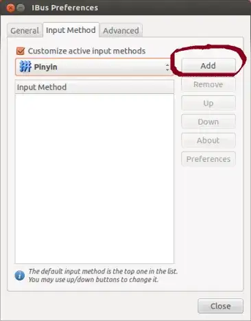

The Select an input method text will change to Pinyin. Then click Add.
Ibus preferences input method tab
You should now see Pinyin in the list of installed input methods. Then click Close.
