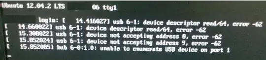

I came back to work after a week away and this is what greets me:
If I press enter it displays the tty1 login prompt.
I have booted using a 12.04.2 Live USB and it seems to work fine, I`m using it to write this.
I have no idea where to start or what to look for. There are no USB devices attached, besides mouse and keyboard. The same message shows up if I disconnect both and reboot.
Either selecting a "previous linux version" on grub, or apt-get dist upgrade doesn't solve my issue.

The issue was solved removing removing video drivers from Nvidia:
sudo apt-get remove nvidia-experimental-304 nvidia-experimental-310
sudo aptitude purge ~c
