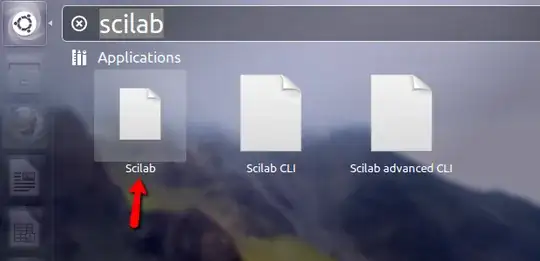

Ok, I just tried installing it, an it worked OK. Here what I did: To install, just press Ctrl+Alt+T on your keyboard to open Terminal. When it opens, run the command(s) below:
sudo apt-get install scilab

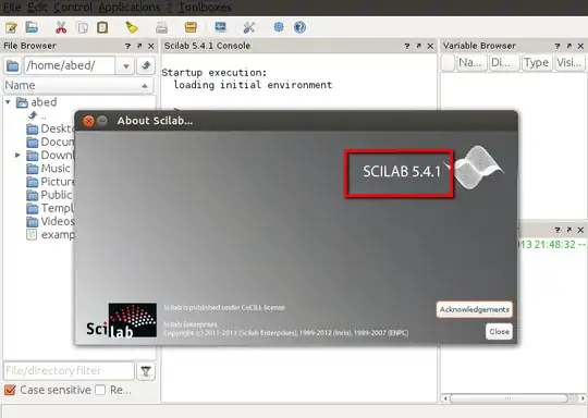

After the installation was done, I searched for scilab in dash, and clicked on it
After I clicked on it, it opened, and I checked the version, and it was 5.4.1
Hope that helps.

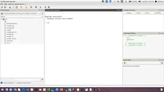

Ubuntu 16.04 LTS:
Once you have downloaded scilab, go to directory in terminal by pressing Crtl + Alt + T, Unzip the package, go to the directory containing scilab. Go to bin and run the command
$ ./scilab
Scilab 6.0.0
akhilesh_k@akhilesh:~/Programs$ cd sc*
akhilesh_k@akhilesh:~/Programs/scilab-6.0.0$ cd bin
akhilesh_k@akhilesh:~/Programs/scilab-6.0.0/bin$ ./scilab

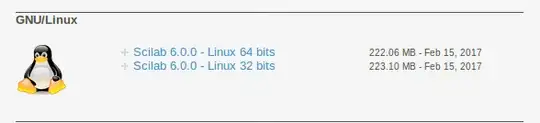

This helps you to choose the right scilab software for you. Now go to scilab download page Depending upon the type of architecture you need to download the right package for you. Mine is 32 bit

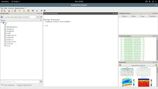

Step 5: For running Scilab use the following command
/usr/local/scilab/scilab-6.0.0/bin
./scilab
