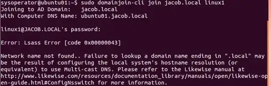

during the command
sudo domainjoin-cli join *domain* *user*
I get the error

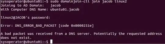

removing the .local and just using the domainame I get this error
Pretty new with Ubuntu and don't know what to do.
just for clarifying, it is a windows active directory named jacob.local
