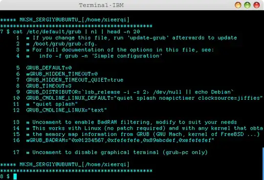

My workaround:
Boot into console mode from the beginning. To do that, edit /etc/default/grub file. Make sure you connnect automatically to your home network, you are on wired network, or at least you know how to use nmcli to connect to a network.
Change line 12 from "" to "text" as shown bellow. Save, sudo update-grub, reboot. Once you are presented with console login screen, go ahead and log in, do the installation, edit /etc/default/grub file back the way it was, sudo update-grub and reboot.

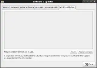

You could install the driver from "Software Sources" in the last tab, if you want a beta driver add the xorg edgers ppa
If you have any hardware that need a nvidia/amd/ati/wifi driver is will show you a option there.
