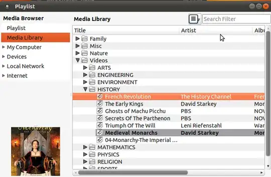

If you do not want to use banshee as a media manager my next suggestion would be the VLC media player from VIdeo Lan, do not let the simple interface fool you, this is a very useful media player outside of just playing media, the playlist button is quite misleading, one would believe that all you have there is something to view or create playlists but this brings up a handy tool that can be used as an interface to the open .xspf playlist format, vlc does a fairly good job of using this playlist format as a flat database it creates a file called ml.xspf in ~/.local/share/vlc so you can back this up, the interface to this file once you get used to the tree view nature is quite handy for searching organizing and playing your videos. Ironically the Media library aspect of this interface works much better than the Playlist aspect.
You can right click on an empty area in the media library window to create folders and drag other folders to them, the folders created in the Media Library window will only exist in the .xspf xml file, whenever you import a folder all the subfolder structure will be imported, this is good if you have a folder system that organizes your files already and you want the same structure in your media library, if this is not desired you can drag out any folder and place them under any other folder or in the root of the tree structure, individual folders can also be imported and placed anywhere in the tree.
You can view the Playlist interface by clicking view in the menu and then click the Playlist item.

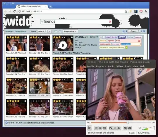

There's a fairly new project called Wwidd, which comes with a cross-platform video tagger. It's available for download, but for Ubuntu installation instructions you'll need to check the readme on its GitHub page.
Once you have it running, it's fairly simple to add and edit tags, even in bulks. I'm managing thousands of videos with it.
Wwidd running on Ubuntu 11.04
Dependencies are: node.js, sqlite3, ffmpeg, VLC (for playback).

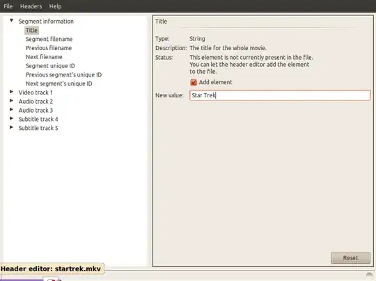

To answer both of your questions I would convert all of your video files to MKV using Handbrake which has a command line version which means you can script the conversion of your files. Within Handbrake you can make the output quality the same as the input but you will be able to use the features of the MKV standard to squeeze the files into a smaller output file. I'm not sure how much compression you will get but its the best you will get without quality reduction.
Once you have converted all of your files you can use one program MKV files creator to add meta data to your video's by using the Header Editor which you can open from the file menu
MKV header editor
Edit
MKV Files creator is a GUI for mkvtoolnix which in turn is a combination of smaller programs including: (each of the links opens the man page of that program)

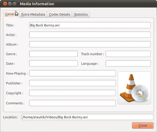

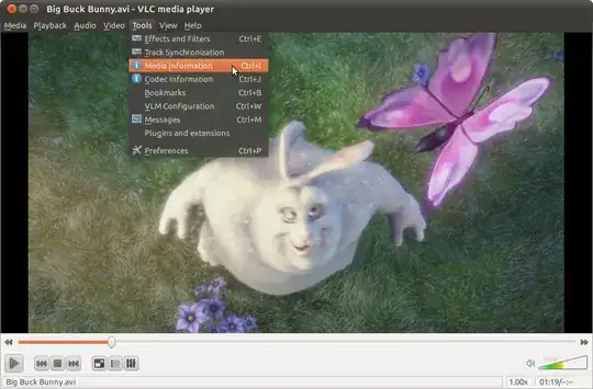

You can use VLC.
To install VLC in all currently supported versions of Ubuntu open the terminal and type:
sudo apt vlc
Open the video file and go to Tools -> Media Information or press Ctrl + I.
Then edit the metadata.
