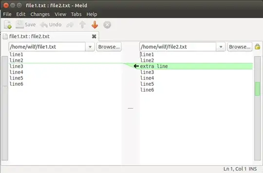

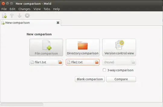

The best I like is Meld
There are many choices available though. As a vim fan I find myself using vimdiff, kompare for the kde crowd - there also some paid version that have linux versions like Beyond Compare . The pros/cons depends on what you're looking for/looking to do.
vimdiff is great because you can run it from a terminal, over an ssh connection, and if you already use vim, you get to keep your tools/config options.
Meld has a pretty clean user interface, and does three way and directory diffs. You'll have to try a couple and see which does the job as you're expecting them to do for your own needs.
To install MeldMeld app page from the Ubuntu repos, you can run:
sudo apt-get install meld
You can then pick the files/folders to compare, and compare them: enter image description here enter image description here

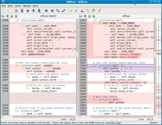

Another one is diffuse
It is free, crossplatform (written in python), has source code highlight, can interact with many version control tools.

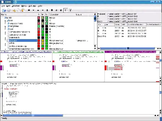

Kdiff3
Is a pretty good 3 way merge tool.
alt text
Some of its features are:
  • compares or merges two or three text input files or directories,
  • shows the differences line by line and character by character (!),
  • provides an automatic merge-facility and
  • an integrated editor for comfortable solving of merge-conflicts,
  • supports Unicode, UTF-8 and other codecs, autodetection via byte-order-mark "BOM"
  • supports KIO on KDE (allows accessing ftp, sftp, fish, smb etc.),
  • Printing of differences,
  • Manual alignment of lines,
  • Automatic merging of version control history ($Log$),
  • and has an intuitive graphical user interface.
  • Windows-Explorer integration Diff-Ext-for-KDiff3 - shell extension included in installer
    KDE-Konqueror service menu plugin
