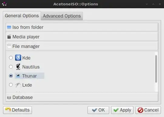

In my case, in Lubuntu, using Furius iso mounter, the path was /home/user/isofilename_ISO. Using AcetoneISO, the path was /home/user/virtual-drives/1. In case the mount point is not automatically accessed, Acetone can be set to do that: go to File/Options/General options/File manager and select file browser (e.g., Thunar or Nautilus, after having installed them: in Lubuntu/LXDE I do not recommend Nautilus, but Thunar; selecting LXDE in that list seems useless). enter image description here
