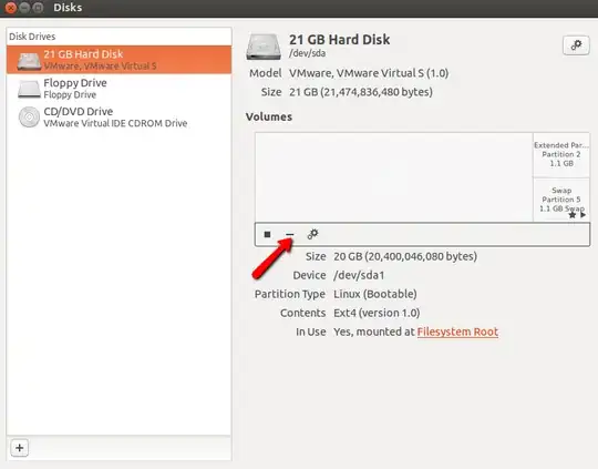

Open disks from dash, delete the partition that's already on the drive by pressing the - sign, Only if no longer needed.

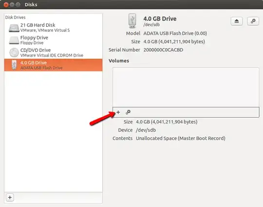

Create a new EXT4 partition, by clicking the + sign, and format the drive.
Once the partition is created, click on the little wheels to format the drive.
