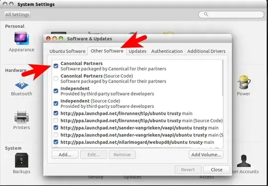

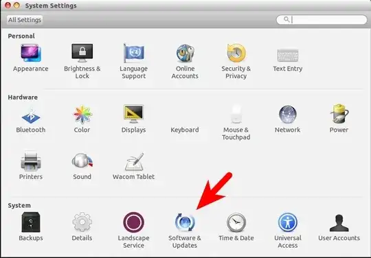

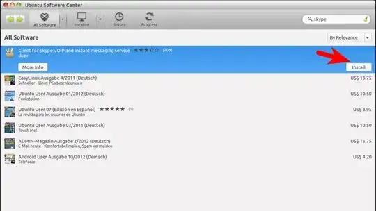

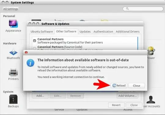

HELP How do I install Skype?
GUI WAY
Go To System Settings > Software & Updates
Then
Authenticate & Click Close
Install It From Ubuntu Software Center

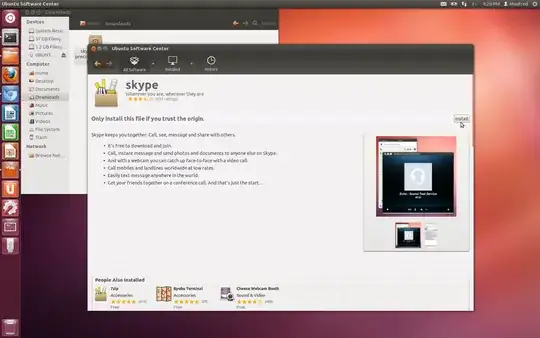

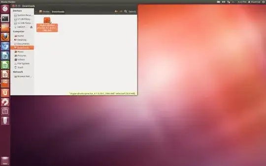

To install skype:
You can either do it the easy way by typing this into your Terminal : sudo apt-get -f install skype or you can Install skype manually by following these steps:
  1. Go to Skype's homepage and download Skype for ubuntu: Skype Download for Ubuntu
  2. When download is finished, go to the download folder where you downloaded Sype.
  3. Right click on the Skype-package you downloaded and click on open with ubuntu software centerenter image description here
  4. After that this window should open: enter image description here
  5. Now press on install, located in the right corner, and wait until the installation is complete.

it looks like skype is not in the standard repositories anymore, and also not in the software center. I also had no luck with the downloaded version.
This is what did work: go to settings -> software and updates. now under the 'Other software' tab check the 'canonical partners' sources. after this I did a sudo apt-get update and than sudo apt-get install skype
