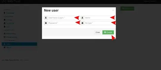

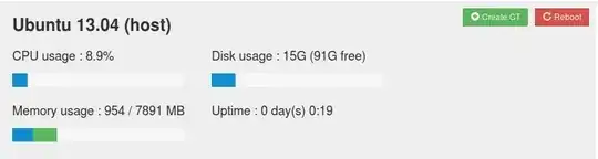

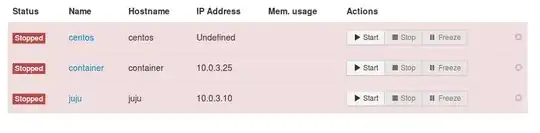

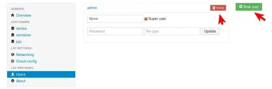

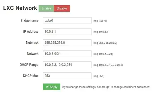

Overview
Containers Overview
LXC Network
Container Settings
Resource Limitation
User Modification ( Create, Delete Modify )
