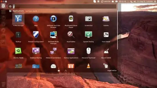

Open Y ppa From Dash

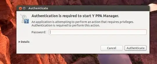

Enter Your Admin Password

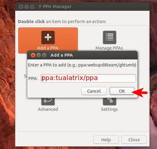

Double Click On Add PPA
Enter The PPA Click Ok To Confirm
