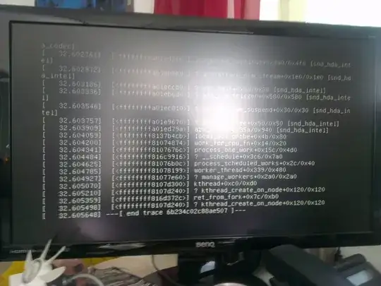

Today I tried booting my dualboot win7 / linux machine, with following errors: At some point it doesn't boot at all. It gets through grub, also shows the splash screen (sometimes) and then jumps back to a black screen with just a underscore blinking (and never leaves that. It also seems my keyboard isn't recognized there at all).
So I searched through the net and tried to boot into recovery mode. Now exactly this error Error "fixing recursive fault but reboot is needed" comes up, but the fix doesn't work. (same results). Sometimes, after this "recursive fault" problem pops up, it's also giving me a message like "udev timeout killing /sbin/..."

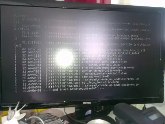

here are two more screenshots of errors (uploaded to google drive) https://drive.google.com/folderview?id=0B-vDF--PkpIaZ2FvdDJ2Uk84Njg&usp=sharing
edit: what i forgot: ubuntu boots just fine from a live cd edit2: I also now edited everything out of fstab which was "not essential" (e.g. everything except / and /home ) edit3: seems to be that one https://bugs.launchpad.net/ubuntu/+source/linux/+bug/1177086 edit4: manually installed latest kernel ( v3.9.1-saucy/ ) didn't help. same issue again. edit5: i finally decided to wipe. I wiped and reinstalled, updated to 13.04... unity does no want to show up, no matter what i do. finally wiping again and staying at 12.10. this sucks. If there is anything I can help you more with... please ask.

I exactly get the same errors on my PC. What I have to do is press F6 and enable the nomodeset option before booting.
