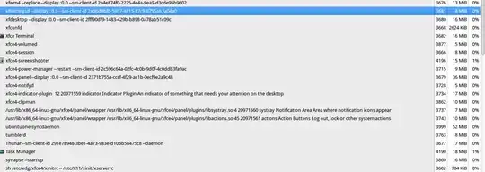

I am experiencing some critical bugs during a critical time (finals week) and could really appreciate some life-saving help. I have posted about it at https://bugzilla.xfce.org/show_bug.cgi?id=10068, but have yet to receive a response from a xfce developer.

I think this usually happens on machines running 64 bit Ubuntu. An updated package hasn't been released yet, but the necessary patch is in git master for xfce4-session, so you could compile from there. Otherwise, probably best to use another desktop environment if you are doing critical work on your machine.
