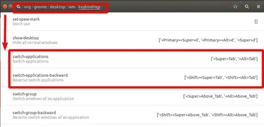

  3. Find: org/gnome/desktop/wm/keybindings
    Screenshot to find keybindings

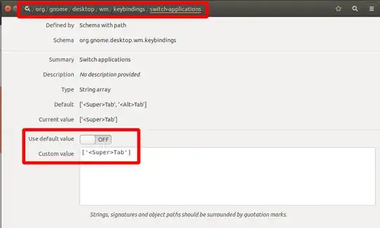

      Find: switch-applications
      Change: Use default value = false
      Change: ['<Super>Tab', '<Alt>Tab'] to ['<Super>Tab']
      screenshot remove default behavior alt+tab

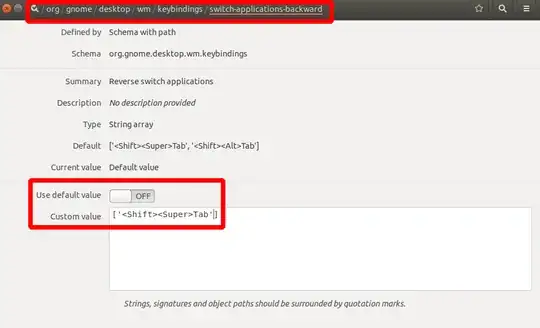

      Find: switch-applications-backward
      Change: ['<Shift><Super>Tab', '<Shift><Alt>Tab'] to ['<Shift><Super>Tab']
      screenshot remove default behavior shift+alt+tab

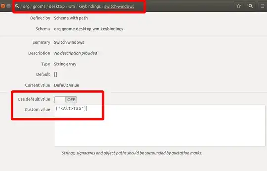

    3. Set new behavior: Alt+Tab
      Instructions
      Find: switch-windows
      '' to ['<Alt>Tab']
      screenshot set new alt+tab behavior

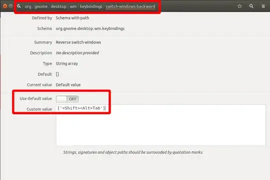

    4. Set new behavior: Shift+Alt+Tab
      Instructions
      Find: switch-windows-backward
      '' to ['<Shift><Alt>Tab'] enter image description here
