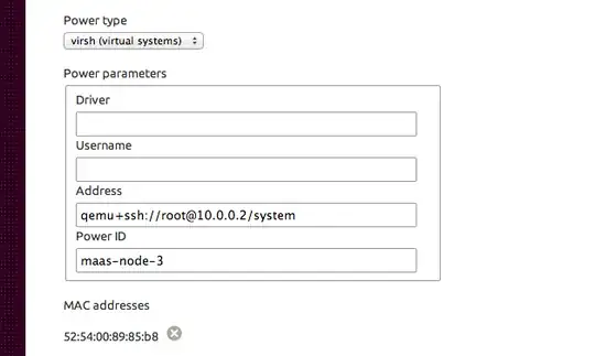

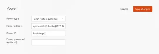

In maas 1.2 through 1.8 the virsh power type requires only the Address and Power ID.
MAAS 1.8 Screenshot MAAS 1.8 virsh power settings
MAAS 1.2-1.4 Screenshot MAAS 1.2-1.4 virsh power settings

the Power ID is the name of the virtual machine shown by sudo virsh list --all
The address is a normal libvirt connect string:
qemu+ssh://ubuntu@10.0.0.2/system
or
qemu:///system

Driver and Username are not required for virsh. They will be deleted eventually.b
