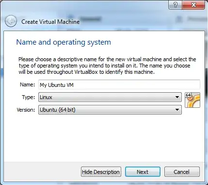

When creating a VM using VirtualBox, the first screen you are presented with asks for the name of your new VM and attempts to auto-detect which operating system you're installing. Make sure that you select Ubuntu (64 bit) in the OS drop-down menu. Just selecting Ubuntu in that menu will result in the error you have described.
Screenshot of 64 bit VM selection
