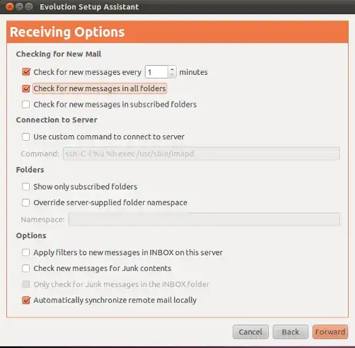

There are several settings for an IMAP account you can make in Evolution. On first startup, or when you create a new account, or in case you already have an account by selecting Edit -> Preferences -> Mail Accounts -> account@provider -> Edit -> Receiving Options you will be presented the following options:
The settings given here make sure that all mails are displayed in Evolution. As soon as you check only subscribed folders, start to apply filters, or check for junk mails you risk that only part of your mails are displayed.
Only if there is no success with settings then as a last resort you may have to delete the local IMAP folder to force reloading as has already been suggested.

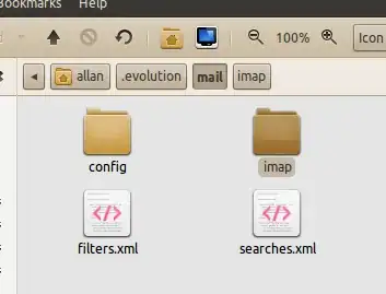

To force evolution to reload the entire IMAP account is to delete the IMAP folder in the hidden evolution folder in your home folder while evolution is closed.
IMAP folder
Alternatively if you have multiple IMAP accounts you can go in to the IMAP folder and delete the folder pertaining to that account.
IMAP Account folder
This will force evolution to reload the entire account.
