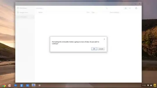

Now, on to the tutorial! I’ll be using a 16GB Sandisk Extreme SD card for this tutorial. At 20MB/s it’s not the fastest out there, but my Extreme Pro cards are all filled with important pictures so I couldn’t use one this time around. As a side note, 99% of the problems I have had with installing ubuntu have been to do with SD card formatting and partition labels. The best thing to do is simply to use a brand new memory card that has no leftover junk on it. I have had success with formatting a memory card in a camera. If you have any issues, please email me using the contact page and I will help you figure it out. For good measure, I like to format the card in the ChromeOS file app too:

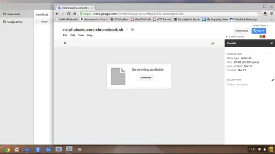

Simon has created a .sh file (shell script) that does a LOT of the work for you. This script can be found here: https://docs.google.com/file/d/0B6ujqV3C76WhaktVbEFuanNQN2s/edit?usp=sharing or http://paste.ubuntu.com/6148392/

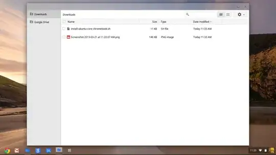

Download to your “Downloads” folder on the chromebook – do NOT rename it (or name it install-ubuntu-core-chromebook.sh).

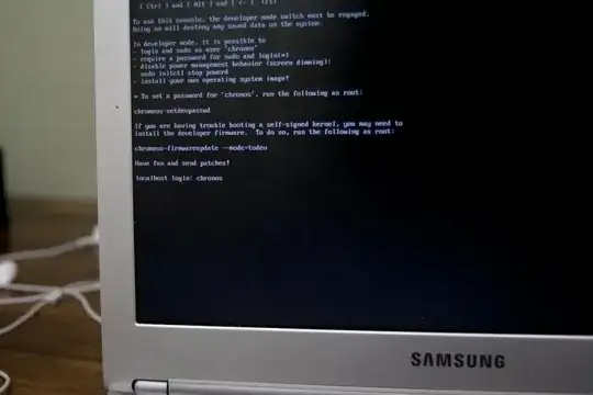

Head over to your console by pressing Ctrl+Alt+. Log in as “chronos” (simply type chronos on the first line and hit enter).

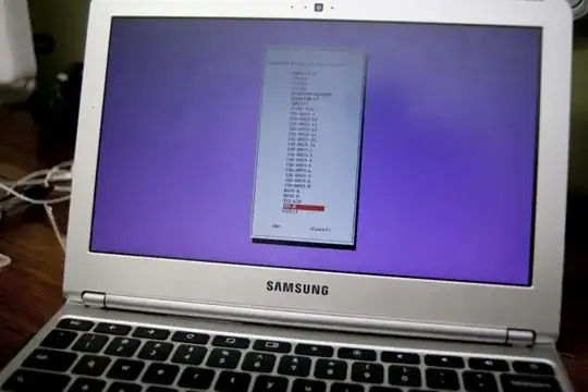

You may need to hit enter a couple of times to get it running. If you see a “/dev/mmcblk1p7 is mounted” error, you forgot the asterisk. If you have any GPT labeling errors, you didn’t format correctly. Once started the process will take about 10 minutes depending on the speed of your card. During the process you have to input a few options, including keyboard layout and encoding. Simply choose the ones that best fit you (U.S. keyboard, UTF8 formatting etc.).

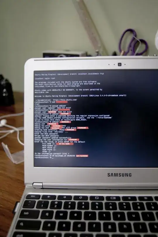

You’re VERY nearly finished. It’s time to get Ubuntu up and running. The first thing you will want to do is log in as root. Simply type root and hit enter. Let’s take a minute and set the root password, by typing passwd ROOTPASSWORDHERE. Now simply type adduser YOURUSERNAME so you can add yourself as a user. So for example, I typed adduser whatthetech. Make sure it’s all lower case without spaces. Enter the info and password that you want, and confirm.
Here’s a picture of the full process (including where I tried to add a password before having a user, and tried to add a user with an uppercase letter – I’m human too…lol):
Now let’s get connected to wi-fi so that you can finish the install. Type sh quickwpa.sh myssid mykey where “myssid” is the name of your wi-fi network and “mykey” is the password. It will take a few seconds to connect.
