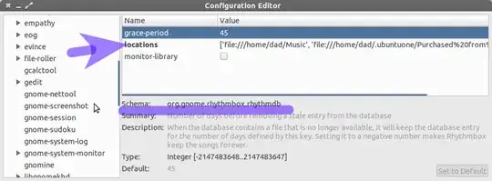

In the preferences window you may have a location/multiple locations where rhythmbox is monitoring both the folder(s) set and also sub-folders
pic
You can change these locations either via the Browser button - or using dconf-editor
dconf-tools
Install dconf-tools
