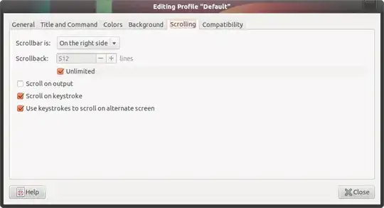

I know in the xfce4-terminal there is a option to increase the number of lines shown:
For ubuntu Terminal enter image description here
Aside from that there is what @Zelda64fan said.
