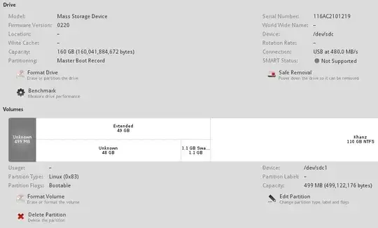

Disk /dev/sdc: 160.0 GB, 160041884672 bytes
255 heads, 63 sectors/track, 19457 cylinders, total 312581806 sectors
Units = sectors of 1 * 512 = 512 bytes
Sector size (logical/physical): 512 bytes / 512 bytes
I/O size (minimum/optimal): 512 bytes / 512 bytes
Disk identifier: 0x0004e7d0
   Device Boot      Start         End      Blocks   Id  System
/dev/sdc1   *        2048      976895      487424   83  Linux
/dev/sdc2          978942    96874495    47947777    5  Extended
/dev/sdc3        96874496   312575999   107850752    7  HPFS/NTFS/exFAT
/dev/sdc5          978944    94726143    46873600   83  Linux
/dev/sdc6        94728192    96874495     1073152   82  Linux swap / Solaris
I can recall for sure that have seen a thread here when a similar problem occurred & in response someone gave solution of how to mount (now invisible) partitions & recover important data in them. I have misplaced that URL so if any can guide me thither because my important documents resides in / partition
