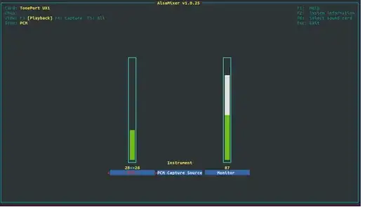

Third, I attempted to use AlsaMixer. By pressing f6, I was able to switch the sound card from the default Intel sound card to the Line6 Toneport. The mixer looks like the following for playback...
Playback
When I change the middle channel to "Instrument" and turn the volume up on my Toneport, I am able to hear my classical guitar. Success!... sort of.

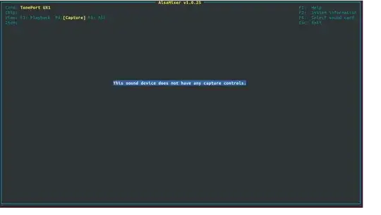

However, when I press f4 to display capture capabilities, the following pops up...
Capture
