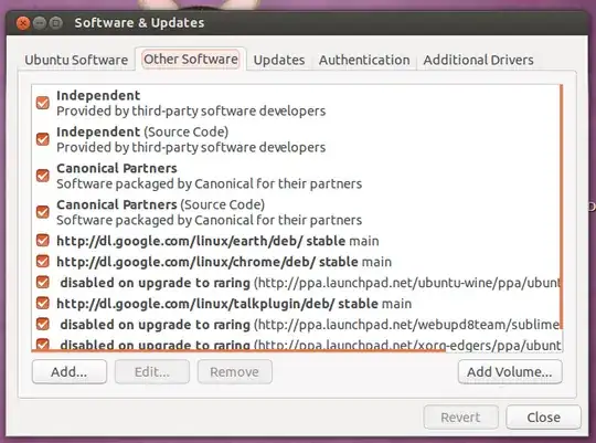

Open your Software Updates windows:
Go to Other Software and remove/disable the PPAs related to http:/ppa.launchpad.net/ferramroberto/gsharkdown/
Close the Software Updates and repeat your update process.
