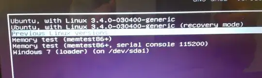

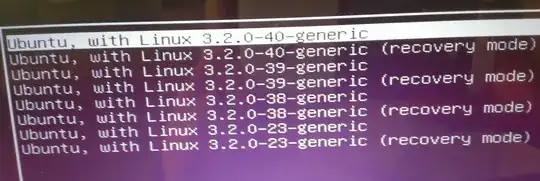

My question is how can I reverse back to a kernel version. I have installed the brand new kernel version, that is 'Ubuntu, with Linux 3.4.0-30400, I did the correct procedure. How to Upgrade Kernel Version?. But when my machine booted with the new kernel, by the grub boot screen as I clicked, it does not load the operating system. It get's stuck at the boot process. After this event I went to a previous version, that was the default, 'Ubuntu, with Linux 3.2.0-39-generic kernel.' It works correctly. How can I get this working kernel to boot up in the first place kernel, and change the default kernel, to one that works.
If you can please explain/instructions, I would appreciate it.
Thank You

sudo apt-get purge linux-{headers,image}-3.4.0-30400-generic linux-headers-3.4.0-30400
will remove the offending kernel, so the old one will boot by default.

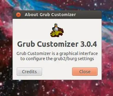

The solution to this problem, is by using the program Grub Customizer.
