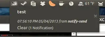

You can install the package indicator-notifications which keeps track of notifcations that you receive. You can install with the following
sudo add-apt-repository ppa:jconti/recent-notifications
sudo apt-get update
sudo apt-get install indicator-notifications
You'll have to log out and log back in. It shows up as a mailbox in the top panel and turns green when you get new messages.
Notifications
This is on 13.04 but should work on 12.04 as well.
