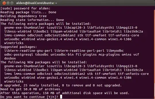

I was uninstalling wine, and I saw that it also uninstalled LMMS at the same time. Thinking it was just something weird that happened, I went and tried lmms - naturally, it didn't start, saying it was uninstalled. So I tried sudo apt-get install lmms, and it listed wine1.4 as a package to be installed.
Why does LMMS need wine to run? It seems kind of counterintuitive/silly that Linux Multimedia Studio needs to be run as if it were made for Windows, not Linux.
Edit: My system is fully updated, and here's a picture of my terminal output when I try to install lmms. Note that all the other components, as listed by Uri, are installed completely: enter image description here I also tried sudo apt-get -f install, sudo apt-get clean and sudo apt-get autoclean, and none of those helped.

Package lmms does not actually depend on wine. Rather, lmms recommends lmms-vst-server, which in turn depends on wine, and such recommended packages are treated as dependencies by default.
To install lmms without its recommended packages including wine, you may prefer to use:
apt-get install --no-install-recommends lmms
