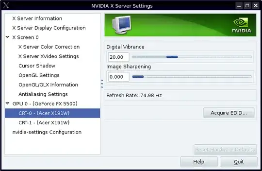

I've had great luck just installing the drivers through synaptic. Have you tried that yet? When installing from there, yes there is a GUI for config.
On the technical end I'm not really sure if they are any different. Sorry, I'm still learning Linux.
What I did was load up synaptic and search on nvidia. You will get several options, just select nvidia-<version>-updates-dev and nvidia-settings-<version>-updates for installation. The most current version right now is 313, but I had good luck with 310 as well.
Let those install. Shouldn't take long. While you can technically do a sudo /etc/init.d/lightdm restart (or whatever windows manager you are using) I prefer to just restart. No issues along that road for me.
nvidia-settings gui for reference:
