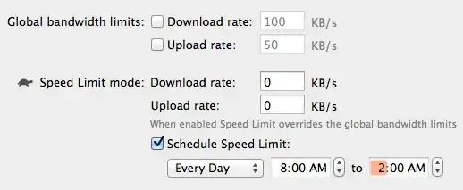

The Speed Limit in Transmission throttles the upload/download speeds during the time set. What you want to do is set the upload/download speed values to 0 and implement that starting at 0800 and end at 0200. That should deactivate all uploads/downloads starting at 8am until 2am the following day.
transmission preference
