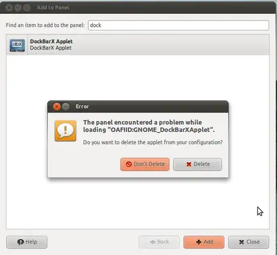

I used to have dockbarX applet installed on my gnome panel. However one day when I login in I got a error message which can be seen in the screenshot below. So I removed it, and then tried adding it again to the gnome panel but I still get the error message.
I am running the latest version of dockbarX 0.43 on Ubuntu 10.10 Maverick Meerkat with the helpers enabled and media buttons etc. I did not update it recently and have been using this version for a couple of weeks now and got this problem only now.
I tried a reinstall of all the components of dockbarX but still get the error message.

How can I solve this problem?

Ok, that's a known problem. There's a bug in zeitgeist and DockbarX 0.43 don't handle that error as it should. Next version will simply not use zeitgeist if there's an error instead of crashing.
It might take a while before the next release of DockbarX (I'm doing some code cleanup that is much more work than I suspected). In the mean time, try to install zeitgeist from the ppa (ppa:zeitgeist/ppa) or remove the ppa and downgrade zeitgest to mavericks own version if you already use the ppa.
