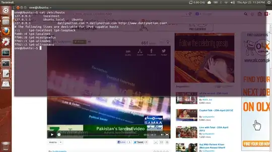

My Hosts file
 127.0.0.1       localhost
 127.0.1.1       Ubuntu.local    Ubuntu
 127.0.0.1       dailymotion.com *.dailymotion.com http://www.dailymotion.com*
 # The following lines are desirable for IPv6 capable hosts
 ::1     ip6-localhost ip6-loopback
 fe00::0 ip6-localnet
 ff00::0 ip6-mcastprefix
 ff02::1 ip6-allnodes
 ff02::2 ip6-allrouters

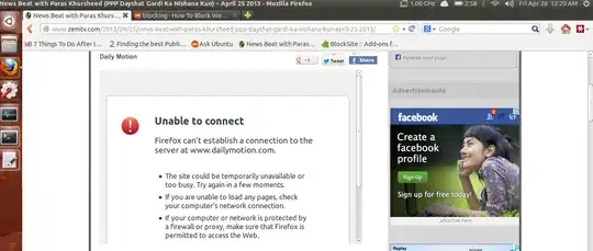

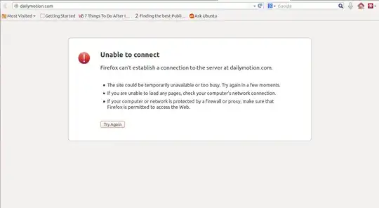

As added in hosts file the site is blocked enter image description here
Copy Paste The Video Link ....Site is not Block enter image description here
