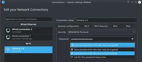

Verax gave the best solution in comment:
In addition to setting the "All users may connect to this network" as user311982 described (Which I find is only disabled by default for Wifi networks, not Ethernet), which by itself didn't do the trick for me I found the KDE Connection Settings Module, after selecting a Wi-Fi network and navigating to the "Wi-Fi Security" tab: Edit Network Connections It makes sense that you'd need to choose "Store password for all users" instead of the default "Store password for this user only" so that the password may be accessed before you unlock the wallet.
