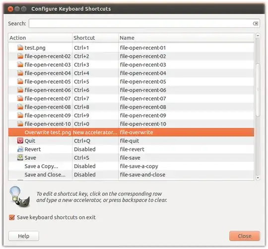

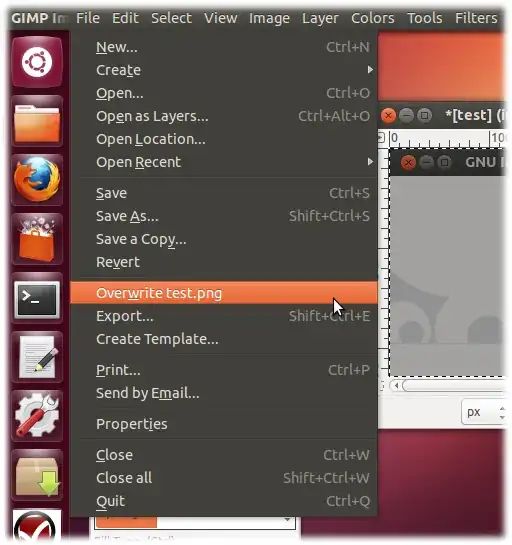

For my workflow here the definitely fastest way to safe an edited file back to the path it resides is using the "File -> Overwrite xxx" menu which appears after an existing file was edited:
To further speed things up we can also define a key shortcut for file-overwrite which, after removing the shortcut for file-save could also be Ctrl + S :
