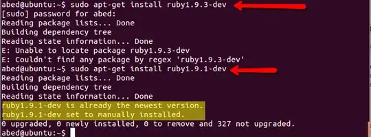

From researching, it says that ruby1.9.3-dev doesn't exist. And that ruby1.9.1-dev is its alias. Here is what I've done. I installed ruby as stated above, and then ran the command sudo apt-get install ruby1.9.3-dev, and I got the same error. But when I ran sudo apt-get install ruby1.9.1-dev, this is what I got:
