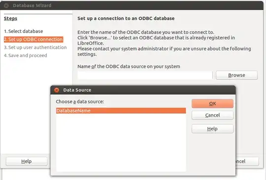

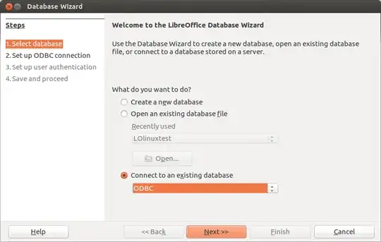

  3. Start Base. It will usually open to the open/import database wizard. You can also open the wizard from any other LibreOffice program through: File >> New >> Database.
    a. Choose Connect to an existing database >> ODBC
LibreOffice database wizard
b. Browse to your datasource
choose datasource
c. Click OK
d. On the next two screens, you can Test the connection, then save the database with a new name, and open it for editing.

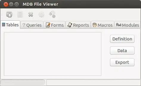

Using Gnome mdb viewer
Install MDB Viewer [Install MDB Viewer](https://apps.ubuntu.com/cat/applications/MDB Viewer) or run in a terminal: sudo apt-get --reinstall install mdbtools-gmdb2
MDB Viewer lets you view and export the tables, schema, forms, queries, macros, and modules. MDB Viewer
These tools are especially useful if you have an mdb file, but no longer have a licensed copy of Access.
