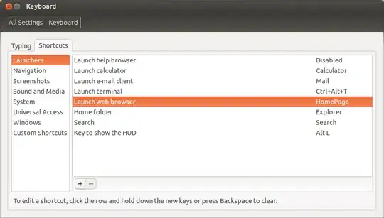

Depending on your keyboard you could assign the appropriate media key or hot key or Function Key to launch browser through All Settings>Keyboard>Launchers>Launch Web Browser which would give one button launch ability.
Launch Browser

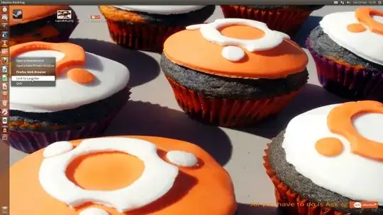

Open your browser and right click the icon in launcher to lock it to launcher.
Lock to Launcher

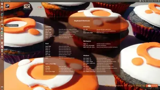

Press and hold the Super(Windows icon) which will show HUD with information regarding keyboard shortcuts.
HUD
Note looking at Launcher your browser icon may have been assigned a number.
I mostly use Firefox and pressing and holding Super tells me Firefox has been assigned the number 6. So pressing Super+6 will launch browser for me.
If pressing and holding Super does not show a shortcut number for your browser
No Shortcut
Just drag and drop the launcher icon to nearer the top of launcher for it to be assigned a number.
