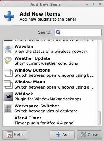

Ok, so I go into the panel to add a new item and of course it's not there:

The problem actually is that Xfapplet was designed to run GNOME2 applets. Since there are no applets for GNOME3 (only extensions and indicators), and the plugin itself hasn't been updated upstream in almost 6 years, there was no good reason for maintaining packages for it. So, even if you get that working by installing old packages from GNOME2, it won't be for a long time.
