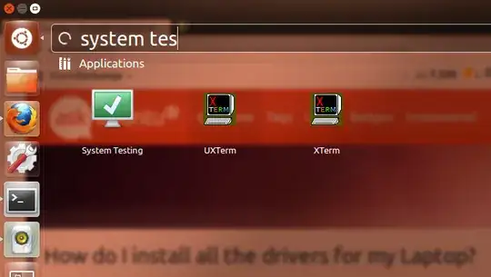

How do I test whether all my hardware is properly working? Is there any standard tool for error checking, benchmarking, etc for checking hardware?
In Ubuntu we have such option with an application named as System testing. You can open it from unity dash by typing as System Testing.
System Testing Opening
After opening here , you can perform all your required tests. Its having everything you need.
Testing Image
Update : if you haven't found it already installed in your Ubuntu , you can install it with
sudo apt-get install checkbox
Hope that helps.

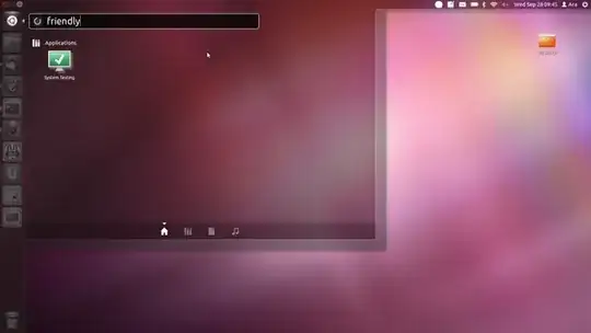

Open dash and start typing friendly. This will get you to a tool that tests your system.
More information can be found here (there is a video there and a run through of the program it starts).
At the end, if you ran all the test, it can upload the results to the Friendly site so others can see what works.

I don't have high enough reputation to add this as a comment so: For Ubuntu 16.04, when you search for "System Testing", the application is called "Checkbox", but does as explained above. It should be pre-installed in the system.
