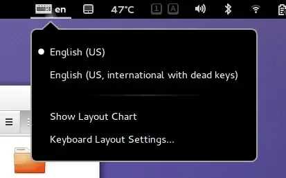

If you mean something like this (Ubuntu 13.04 Gnome Remix):
keyboard indicator
The indication change when you switch layout with your selected keyboard switch combination.

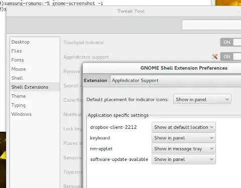

I installed the AppIndicator extension (https://extensions.gnome.org/extension/615/appindicator-support/ ) and then, after the first change of keyboard layout, you have a keyboard-layout notification in the gnome notification zone. Open ubuntu tweaks, extensions, select AppIndicator options:
appindicator extension's settings
and be sure to select "show in panel" for the keyboard indicator.

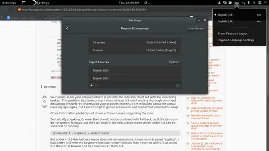

So it would seem your actual problem is not with the indicator itself but with the panel label being broken/not being displayed. This problem has been present since at least 3.4 and I wrote a thorough comment discussing this before I understood your problem entirely. If I'm mistaken about the actual issue my apologies.
This is an image of what I think you expect to see: en1
(Note: the Login Screen link in the Region & Language panel lets you make the gdm login indicator functional as well)
To clarify, I have only tested this in 3.8. Here is what I did:
Install Icon Hider extension from: Icon Hider on e.g.o
Once installed open the icon hider preferences by refreshing the page you installed from or iirc from the menu entry. Now set the "keyboard" entry to On and you should see the blank space.
Next, since I only had one layout by default, and the menu showed I had 0, I decided to add one. Open the blank keyboard menu and launch "Region & Language Settings". If you have more than 1 layout already you should try removing all but your default/preferred language. WARNING: when you have only 1 enabled(3.8) the indicator automatically hides, so you should use the Icon Hider extension to hide/show it again as when you remove the 2nd it will hide. Then I added an alternate and finally the menu showed me an entry, as my default contained no pre-set layout so the menu showed no entry at all.
Now that I added 2 it showed the entries and I selected one.
The result was the image above. I do hope this works but I'm guessing ymmv depending on your g:s version.
