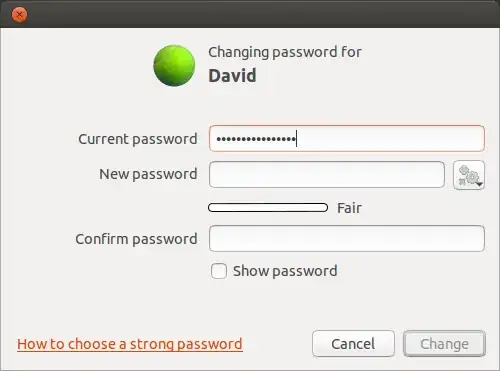

If I attempt to change my password to nothing by opening "User Accounts", the "Change" button remains greyed out:
How do I change my password to be empty? I know you can set Ubuntu to automatically log you in, but I want my password to be empty, I never want to type in a password to authenticate myself as that user.

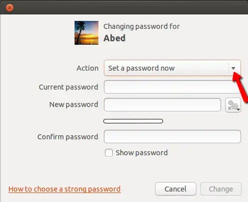

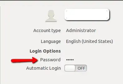

  2. Go into user accounts, and click on the password field:
  3. Once the window opens, click on the down arrow to the right of "Action"...

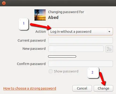

  4. and change it to "Log in without a password", and then click on "Change":

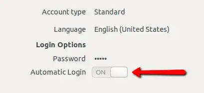

  5. Optionally, you can also enable automatic log-in, like this:
    Screenshot
