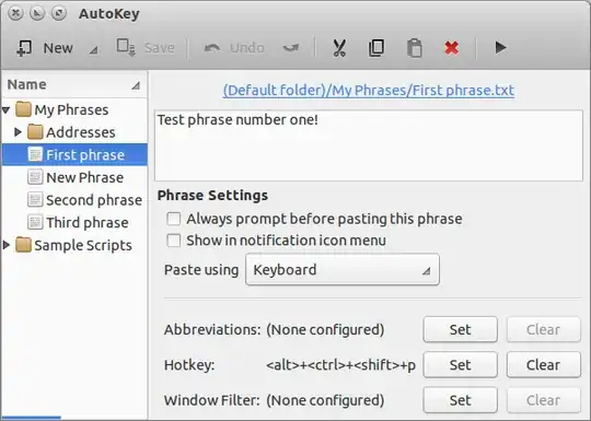

Adding Phrases
autokey using the dash.In the window, expand My Phrases.
autokey already comes with four phrases as you can see in the screenshot below.
Configuring Shortcut Keys
Click on a any phrase name to see the current configuration. In the screenshot above, First phrase is selected.

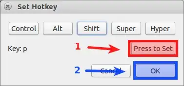

To change the shortcut key or Hotkey, click on Set besides the Hotkey and then click on Press to set in the new dialog box that appears.
Then press the key combination you wish and select OK.

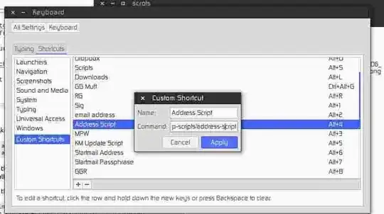

The last step is to bind a shortcut key to your script. In Ubuntu this can be set by going to System Settings/Keyboard/Shortcuts and create a custom shortcut.
