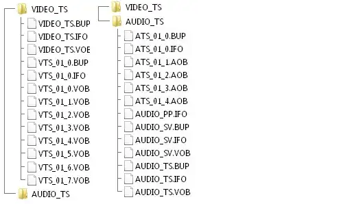

You can do it via command-line :
  • Create a Folder called dvd.
  • Create two folders in that directory called :
    1. VIDEO_TS subdirectory.
    2. AUDIO_TS subdirectory.
  • copy the vob. and ifo. files to VIDEO_TS.
Using mkisofs to create a DVD video ISO image
mkisofs -dvd-video -o dvdimage.iso dvd/
Note: dvd/ is the directory that contains the VIDEO_TS subdirectory (and optionally an AUDIO_TS subdirectory).
The mkisofs command made an iso image dvdimage.isoand you can burn with brasero or k3b; the file name specified using the -o option. And the option -dvd-video was used to ensure that the ISO image has a DVD-Video compliant UDF file system. For more information, see: mkisofs --help

The way I read these messages, it's not a genisoimage error, it's about a missing in file named VIDEO_TS.IFO in which genisoimage expects to find some data it calls "VMG info". VIDEO_TS.IFO is your information file for your menu (are configuration files with information about how to play exactly all video and audio content of DVD (including menus, subtitles, aspect ratio, languages etc.) , I'd guess it expects that file along with your VOB file, check your VIDEO_TS subdirectory or your directory sources to try to find that files.
The IFO file type is primarily associated with 'DVD Info File'. An info file associated with a .VRO video file. The .VRO file contains the video stream and the .IFO file contains various scene and timing information. This is different from a .VOB file where that information is included in the file. Several manufacturers use .VRO/.IFO files. If present, the file VIDEO_TS.IFO consists of control and playback information for the entire DVD. VIDEO_TS.IFO is known as VMGI (The Video Manager Information file). This file is required to be present on a DVD-compliant disc.
VIDEO_TS.BUP is a backup of the VIDEO_TS.IFO check if you have it and make a copy.
Tyìcaly DVD Structure
