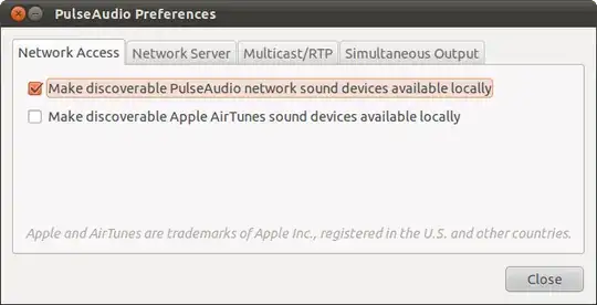

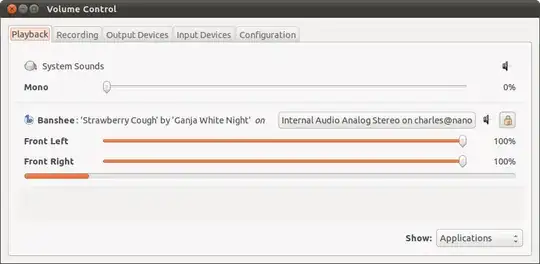

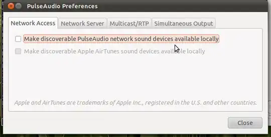

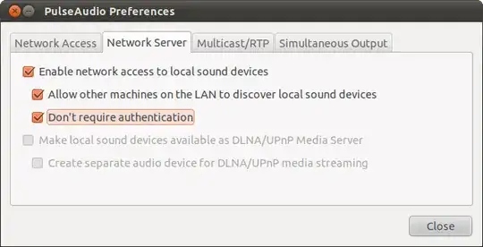

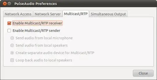

I didnt have to do anything out of the ordinary. I have twin netbooks both with PulseAudio and fairly no name hardware from intel. How I set it up went a little something like this.
run paprefs on both your server and client. On the server, make sure you have have the multicast settings enabled, and the server bits checked. like so enter image description here
and the multicast bit enter image description here
On the client, enable the bit about finding network enabled devices enter image description here and set your output device to the virtual network device via pavucontrol enter image description here
viola you should have some magic now
