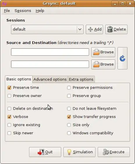

Grsync
Grsync is a graphical front end:
More information:
The link has several examples on configuration.
