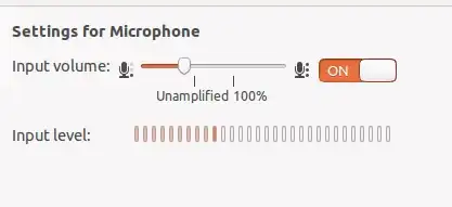

I want to disable the way the microphone lowers itself depending on the input. Here is an image:
The microphone started at 100% and slowly started to drop to where the image is showing. This is because of either a background noise or the user raising their voice. In any case, I would like to prohibit this behavior because when it gets too low, the need to raise the voice will be actually needed.
So is there an option or configuration file where one can edit and change this behavior?
This is not related to only one app but several, ranging from Skype to Google Hangouts, Empathy to Teamspeak and more. So please no answers mentioning only one app if the solution does not solve the problem for others.
the pulseaudio app (gui and terminal) was already used. Alsamixer was also used. In both cases, adjusting the microphone level did not help. The auto adjust always happens when anyone speaks, does not even need to be someone speaking loud, they just need to speak and after a couple of seconds the mic level will start auto adjusting. I repeat, this is not a 1 app problem but several, so a common solution is better than a 1 for each app (Which we are talking about more than 50 apps).

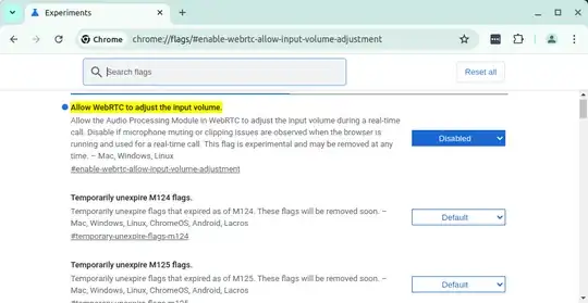

In case you're using Chrome or Chromium, applications may adjust the volume via WebRTC.
This can be disabled via the feature flag "Allow WebRTC to adjust the input volume."
The feature flag can be found by pasting the following URL into Chrome's address bar: chrome://flags/#enable-webrtc-allow-input-volume-adjustment. Don't forget to restart Chrome after setting this flag.
However, according to this comment, the feature flag is about to be removed from Chrome 123.
