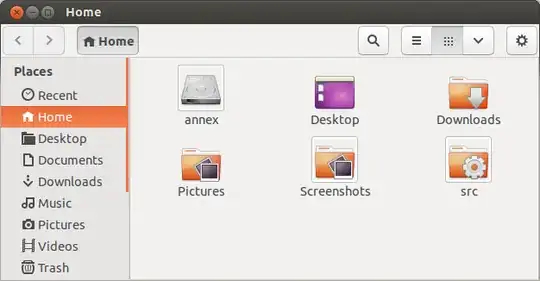

When I set custom folder icons in Ubuntu 13.04, gray boxes appear around them:
Home in Ubuntu 13.04
How can I make the icons just look normal?

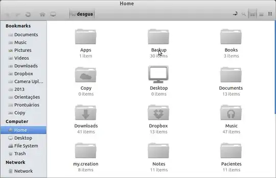

Nemo is a fork of Nautilus 3.4
You can install it with the Cinnamon ppa:
sudo add-apt-repository ppa:gwendal-lebihan-dev/cinnamon-stable; sudo apt-get update; sudo apt-get install nemo nemo-fileroller
It looks like this:
