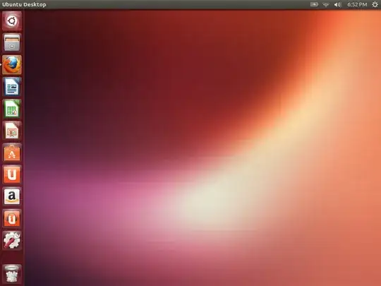

I accidentally opened Orca Screen Reader from the Dash when I was trying to open Screenshot. Now everything I type or click on is spoken out loud.
How do I make it stop?
For reference, here is a screenshot of Orca Screen Reader running:
